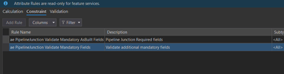

Egardner25
After reviewing the attribute rules, I don't see any constraints on either the EFV or the couplings beyond mandatory field validation. The only constraints present on PipelineDevice and PipelineJunction enforce required fields based on subtype and lifecycle or in-service criteria. I am able to successfully create both the EFV and couplings outside of a group template.
