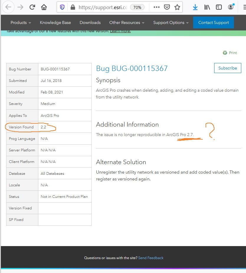

Then this bug persists to exist in 2.7.2 as per the data provided
Jamal Numan
DanPatterson
MVP Esteemed Contributor
did you try in the Alternate Solution which also means this is what to do if you aren't doing something right
It also said it wasn't reproducable and
Not in Current Product Plan
... sort of retired...

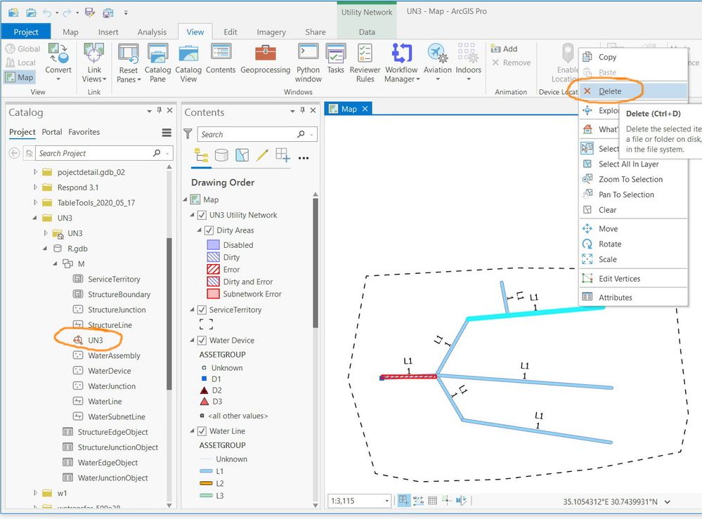

Are you just deleting the UN dataset from the feature dataset and receiving a crash?
If so, this is different than the bug you are including in your screen captures as they are deleting domains.
I cannot reproduce the crash with your UN provided in the zip file, but I am using ArcGIS Pro 2.8.
1. What if you delete the UN at the feature dataset level?
2. Are you able to reproduce this crash with any FGDB UN that has certain domains configured or is it specific to your FGDB dataset?

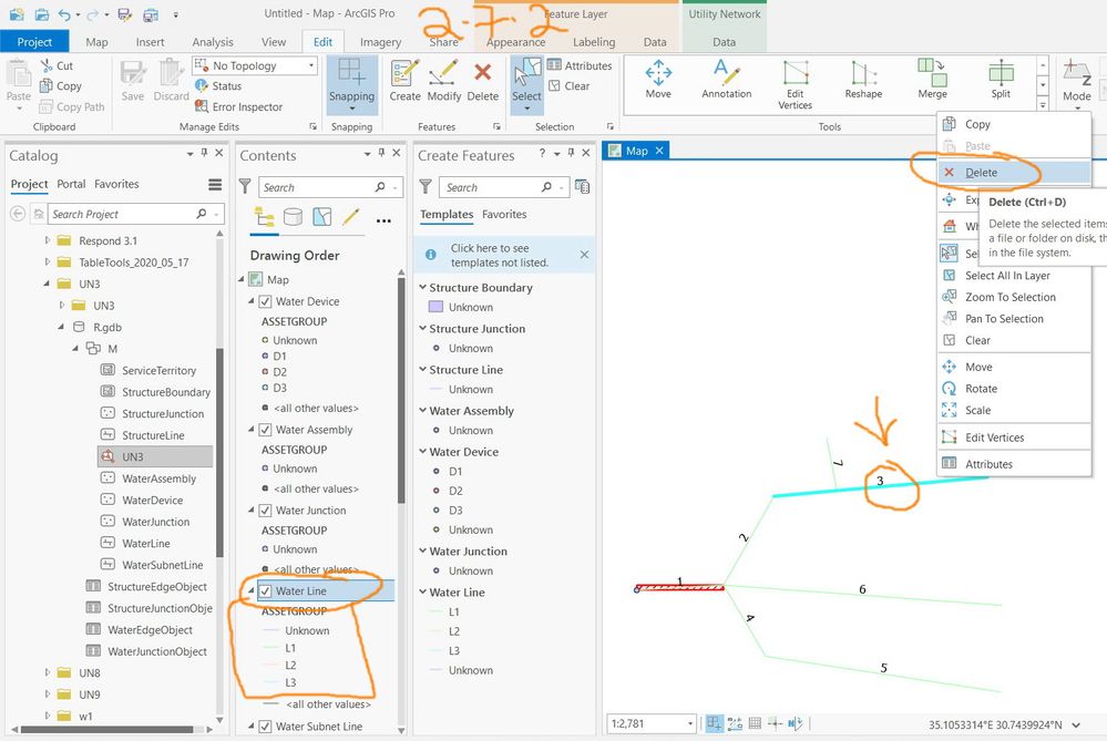

JamalNUMAN
Legendary Contributor
As per the screenshot below, just select feature #3 in the water line layer and delete it. This should cause the Pro (2.7.2) to crash!
