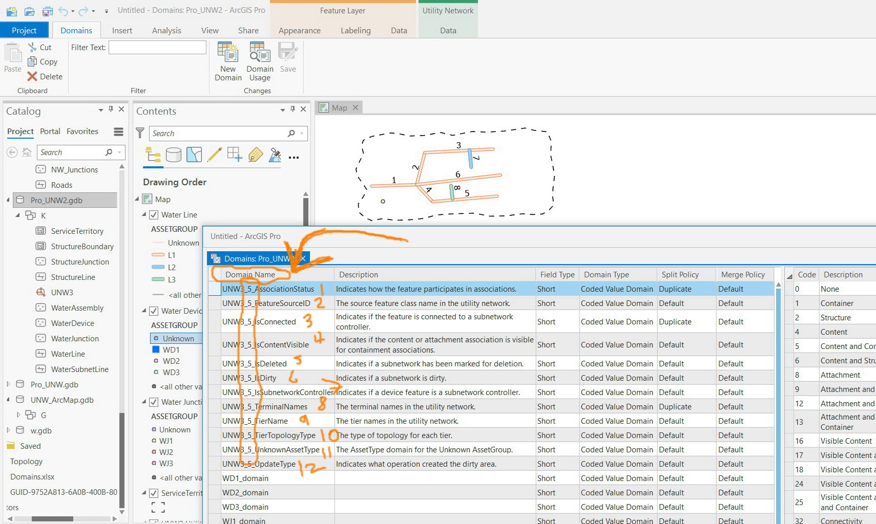

I couldn’t figure out what does number “5” that appears in the default domains of utility network indicate for?

That is the dataset ID (DSID) of the utility network. It is used so that domains will not be shared across multiple utility networks (if you have that in your geodatabase).
