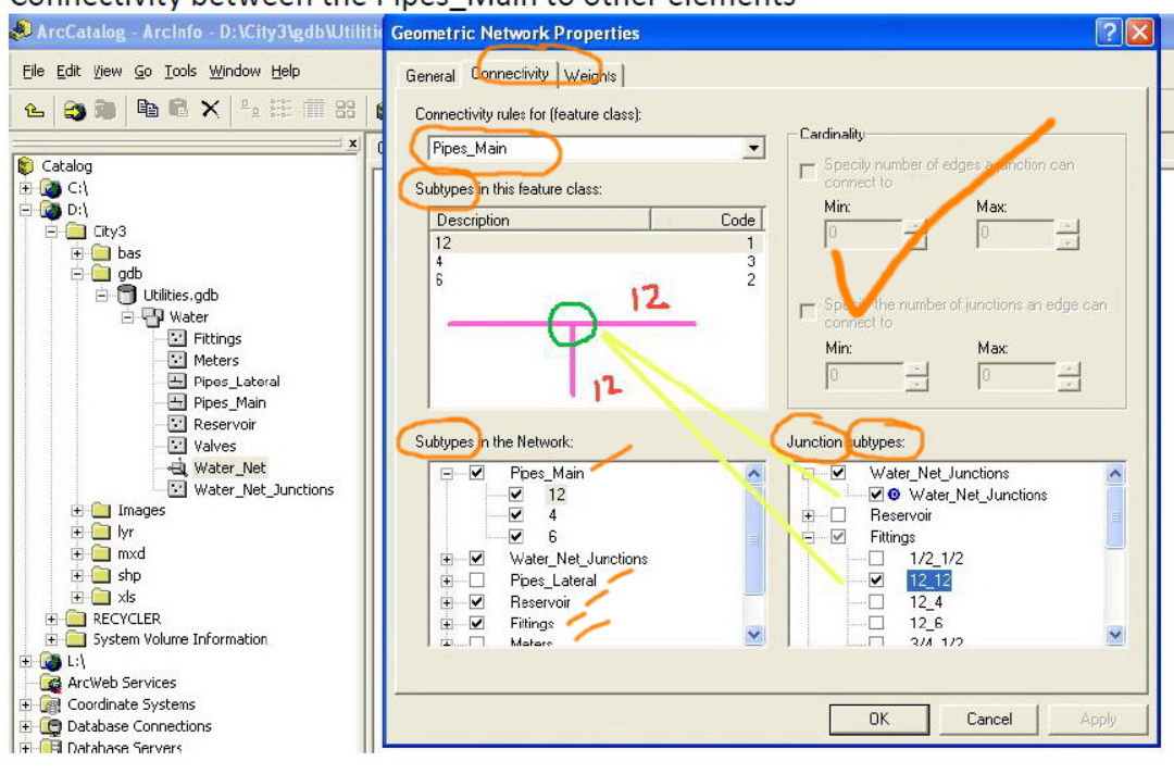

For example, in ArcMap, the all the utility network connectivity rules can be displayed in one place such that one can review and re-configure some of them if needed.

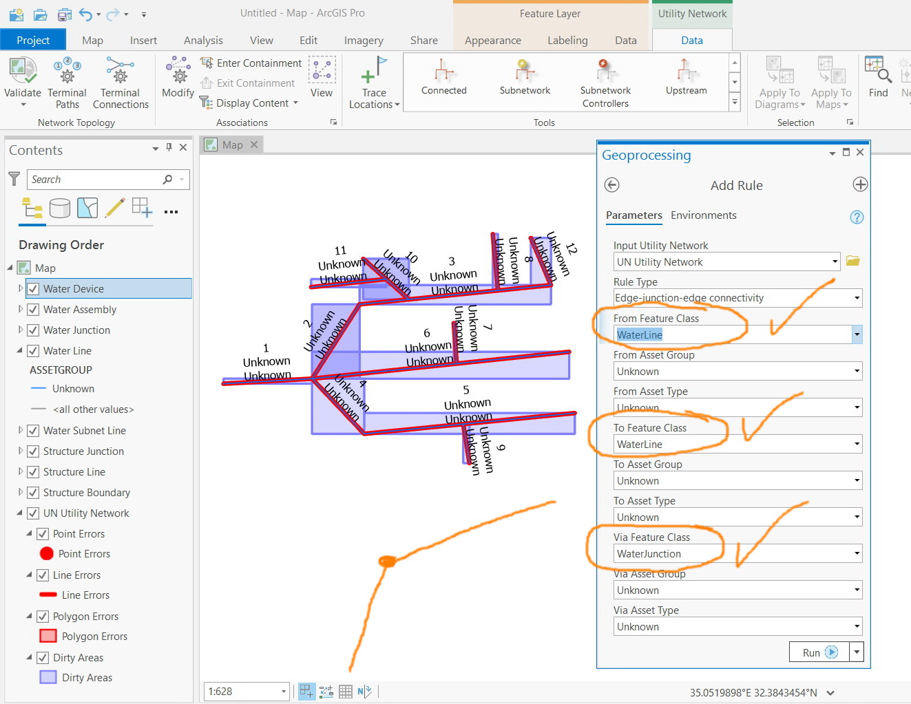

In Pro, I observed that the configuration of utility network connectivity rules is performed by GP tool and couldn’t figure out how to show the already implemented rules
