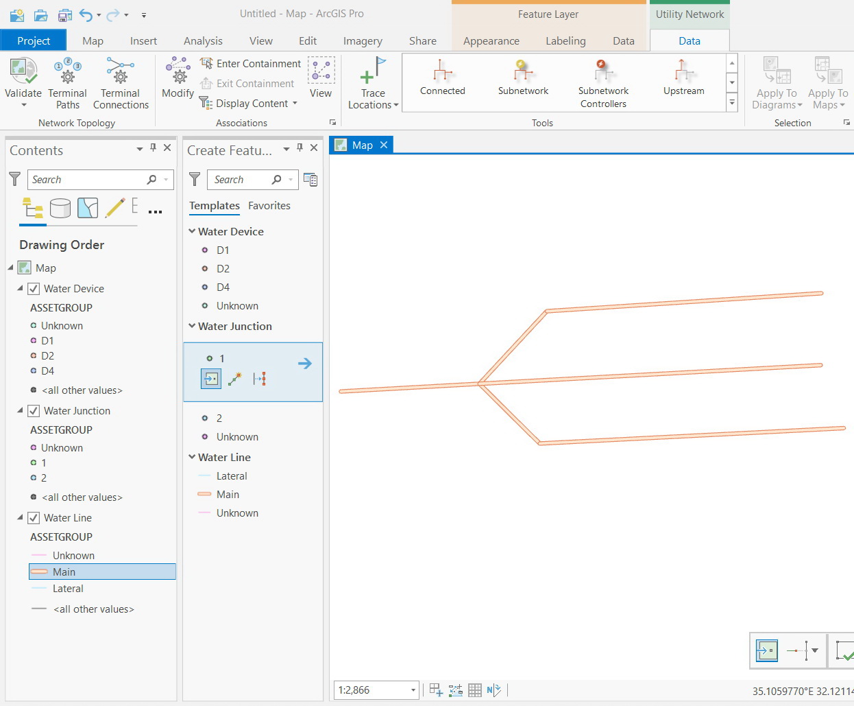

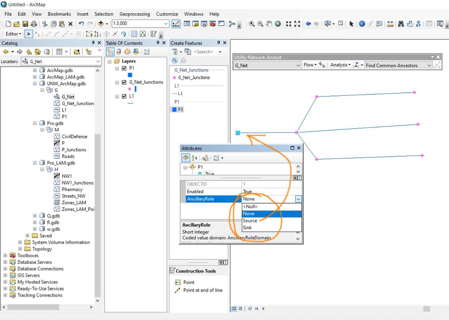

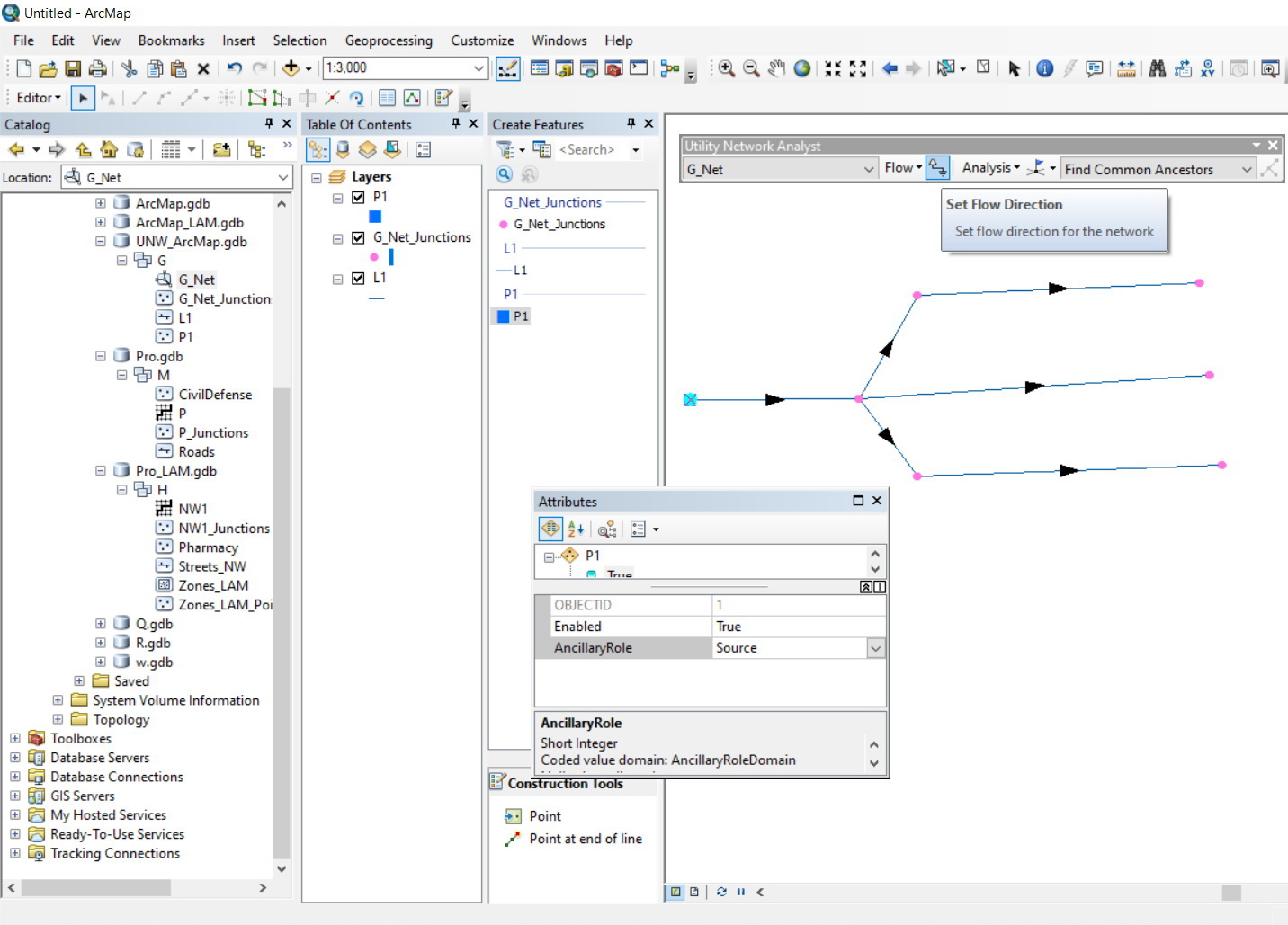

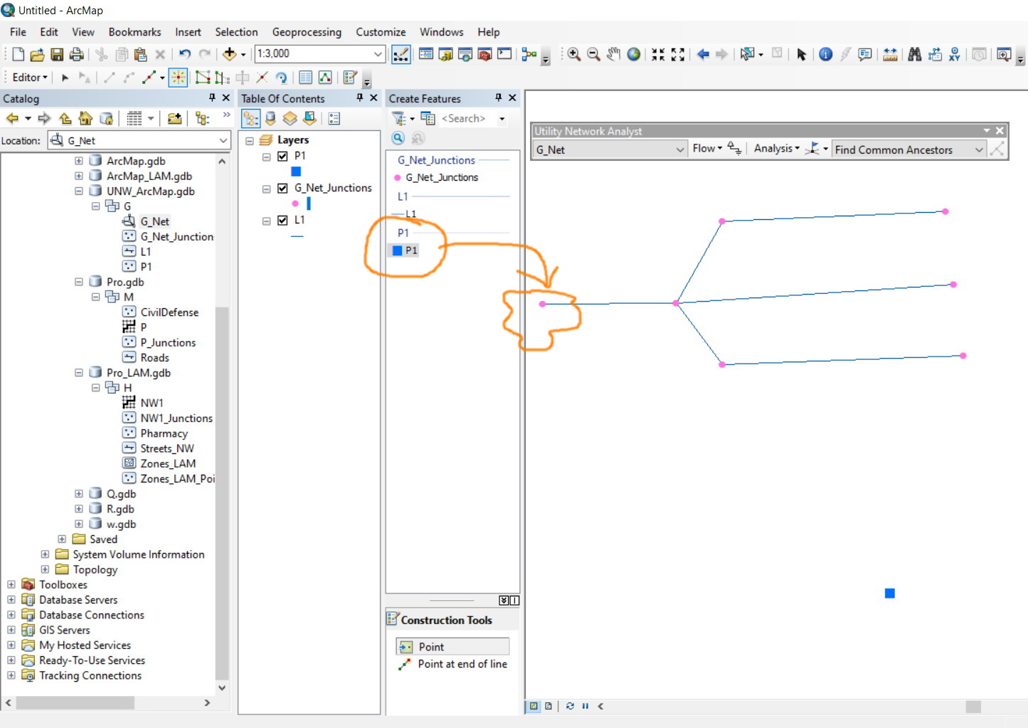

For example, in ArcMap, a method to add a source to an existing utility network is to replace a junction by a point that belongs to reservoir layer and then configure it as “Source”.
How is this performed in Pro?
