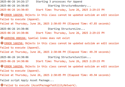

The package successfully applied to the Domain feature classes in the utility network, but fails at the Structure features. Has anyone received this error before when applying an asset package to a utility network?
I am the utility network owner.
Have double checked properties.
Utility network is version 6.

Hi John, yes, the target is a branch versioned enterprise database. I am currently attempting this suggestion to unregister the data as versioned and then turn versioning back on to see if that resolves it. https://support.esri.com/en-us/knowledge-base/error-160250-objects-in-this-class-cannot-be-updated-o...
This worked for me! After was able to successfully apply asset package for structure domain. Data did not appear in tables/map till I enabled network topology.

My first question would be was the target a versioned Enterprise Database?
