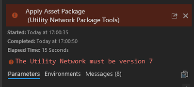

Hello,
I am working with Pro 3.3 and AGE 11.2 and noticed that when run the Apply Asset Package in 3.3, it requires the UN Version 7 - which can´t be here so far, since the Create Utility Network Tool / Stage Network Tool (from UNTools) creates in the eGDB just UN version 6 since it´s latest version supported on AGE 11.2
Isn´t there a way how to enable/force this combination in Applying Asset package (Pro 3.3, AGE 11.2 and UN version 6), without needs to downgrade the Pro?
Thank you.
Vladimir

If you want to apply an asset package to a v6 UN, you must be using ArcGIS Pro 3.0 - 3.2 (ideally Pro 3.1).

ArcGIS Solutions has updated Utility Network Package toolbox 3.3.1 with a new parameter in Stage and AP to Geodatabase to specify the Utility Network version to create (6 or 7).

If you use the tool to deploy an asset package to a mobile or file geodatabase it will deploy a v7 utility network. The utility network knows to create a utility network at v6 when deploying to an enterprise geodatabase and it is connected to an ArcGIS Enterprise 11.2 Portal, so this is likely an issue with the UN Tools from ArcGIS Solutions.

Hi @NadiaAlami, yes I´ve installed ArcGIS Enterprise 11.3 (it was released yesterday). It works there. If you have older Enterprise, you have to use, as @PaulLeBlanc1 and @RobertKrisher  mentioned, older version of the ArcGIS Pro.
