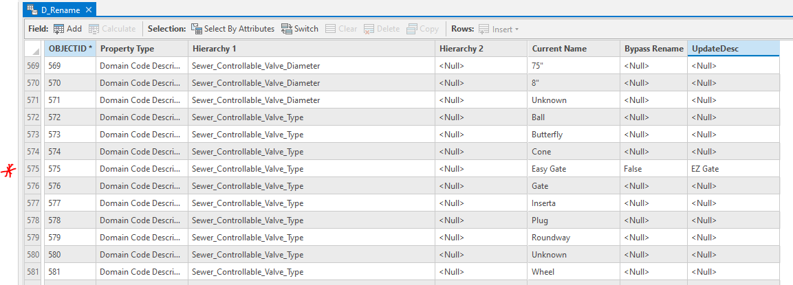

I have a question on the D_Rename table within the asset package. I was attempting to rename a coded domain description, but when I go to apply asset package to my UN in a .gdb I am getting an error. Is this a case where once topology has been enabled on the UN you can no longer make a name change using the D_Rename table? In this example I am trying to update a coded domain description in a valve type domain. I understand I could just make the change directly in the UN .gdb, I am looking to verify the intended behavior of D_Rename table.

Once the network topology has been enabled, you cannot change the Subtype Descriptions, Asset Type Descriptions (in the coded domain) or Terminal Names and a few other Utility Network properties.  Once the Network Topology has been enabled, it is only additive.
