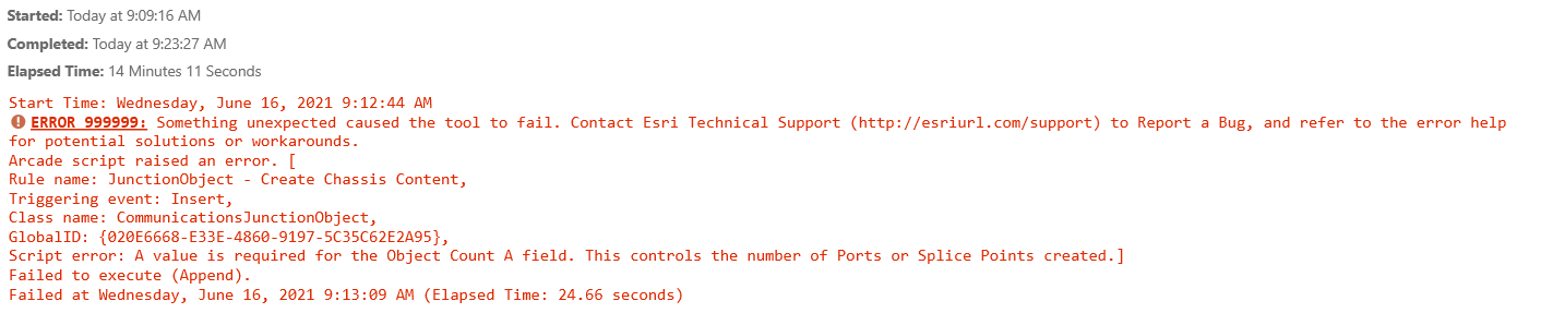

I recently downloaded the Comms v 1.1 UN and AP FGDBs, and have loaded to the AP some fiber features to CommunicationsLine, CommunicationsEdgeObject (fiber strands), and C_Associations (to relate the fibercables with strands). I am now attempting to run Apply Asset Package to load the data into the UN FGDB, but am getting the following error. None of the Naperville test data that came with either FGDB had the Object Count A fields populated so not sure why this would be an issue.
Thanks!
