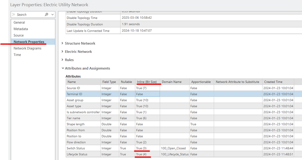

How can I see if the domain is inline? I'm using the Essentials Model for Electric.
gis_KIWI4
MVP Regular Contributor
You can check it under the Network Properties -> Attributes and Assignments
