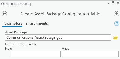

As you are implementing the Utility Network, you will likely add new fields, domains and other items to the Asset Package.  In order to include those items in the Configuration table, you need to update the configuration table.  Since there are read-only fields in this table, you cannot manually add new rows to this table.  To add the new items, run the Create Asset Package Configuration Table tool using an updated asset package and the new items will be added as rows in the D_Configuration table with their values set to Not Evaluated.  You do not need to include any of the existing Category fields, as the tool will automatically detect the existing columns and preserve the values.
Next, you will need to update the values of the newly added rows based on requirements for each configuration. Set the appropriate category columns values to the desired value.

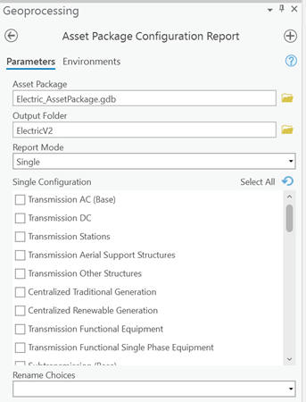

Generating a report
Now that we have a better understanding of the configuration table and how to work with it, you can run the Apply Asset Package or Asset Package to Geodatabase tool, check and uncheck the configuration entries (the alias of the column is displayed) and generate a Utility Network tailored to your needs. This process may take a while on a larger data model.  We provide a tool that will generate an excel report very quickly to ensure the results are what you desire, before running the Asset Package toolset. The Asset Package Configuration Report geoprocessing tool in the Utility Network Data Management Support (UDMS) toolbox is a part of the Utility Network Foundation solution or available via github. Use this report to evaluate the output and verify it meets your organization’s needs.
The geoprocessing tool includes the following parameters:
  • Asset Package – The Asset Package you wish to use to create the report from. It Package must contain a valid D_Configuration table.
  • Output Folder – The Folder that the Configuration report folder will be created in.
  • Report Mode – We recommend using Single for the Report Mode Parameter for a description of how to use the other parameters see the documentation.
 The Asset Package Configuration Report tool creates a folder under the Output Folder named Configuration. If the folder already exists a new one is created with the next sequential number appended to the name.  The output folder contains the Configuration folder with the following structure:
