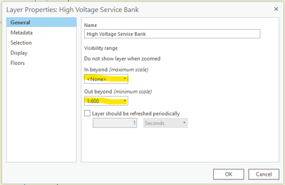

Optimal visible scale range considerations for feature layers
It is a best practice to determine the scale range at which individual feature layers will be rendered. Failing to do so will result in performance issues when the map is being rendered.
For example, if the Line feature layer is set to be visible at the county level, there could be millions of objects that   are rendered and that takes a considerable amount of processing and time. Despite that time and effort, end users cannot perceive any meaningful information. Similarly, a point layer that is visible at all scales will not mean anything when the map is zoomed in at the city level. So, pay attention to your workflows and determine the appropriate rendering scales for each layer. This will dramatically reduce the load when the map is rendering.
Setting a visible scale range at the feature layer level will ensure that these visibility scale ranges are passed to all the maps downstream that will be using the feature service. Depending on the feature service clients, you could fine tune the scale ranges as needed.

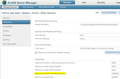

Maximum number of coded domains
Another setting that is sometimes forgotten is the maximum number of coded domains.  The default value of 25,000 may not be large enough for a Utility Network. Change the value to 1 million: 1000000
But why? Let’s do the math. There are at least 12 database objects in your Utility Network. As an example, the Electric Utility Network model contains an average of 38 fields and 13 subtypes in each object. Suddenly the number creeps to a range closer to 25,000. If you choose to enhance the data model, the number of coded domains can exceed more than the default.
Remember, with the default setting, 25,000 is the maximum number of domain codes that can be returned from all fields, subtypes, layers & tables. When the number of domain codes returned by the MaxDomainCodeCount property exceeds the default value, the service may continue to run normally, but you will see the domain descriptions not displaying as expected for some attributes. In addition, errors will be captured in your ArcGIS Server logs.
So, remember to increase the maximum number of coded domains in the configuration tab while sharing the web layer.  Share Tab > Web Layer > Publish Web Layer > Configuration tab > Click the Feature’s pencil icon > Configuration Parameters tab > tip open Advanced
You can also edit it with the ArcGIS Server manager, as shown below.

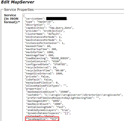

Customers who have very large subnetworks may encounter errors when trying to trace or update them. If you encounter one of the following errors when running Trace or Update Subnetwork: “Error 160213 or Error 003642: A networking error occurred,” you should consider adjusting the max heap size of your utility network feature service (for synchronous operations) and the utility network tools geoprocessing service (for asynchronous operations).
Please refer to this KB article: Determine the proper heap size setting for large trace results in an enterprise deployment of the ut.... While it is possible to set the Max Heap Size at a server level, this will increase the memory usage of all services in that size. Because of this, it is recommended that you take a more targeted approach and only increase the Max Heap Size for service that need it, and that you only make it as large as it needs to be. Increasing the Max Heap Size increases the memory consumption of each SOC used by the server, so setting the Max Heap Size to be 512mb will cause each SOC to consume an additional 512mb of memory even when idle.
When updating a feature service, you must place the javaHeapSize in the properties element of the Feature Service's service properties. This property is not exposed by default in the service, so if this is your first time adjusting this value you will need to add a new property.
Adjusting the javaheapSize property of a Feature ServiceAdjusting the javaheapSize property of a Feature Service

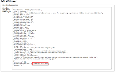

When updating the UtilityNetworkTools GP service you must place this javaHeapSize in the frameworkProperties element of the GP Service's service properties. This property is not exposed by default in the service, so if this is your first time adjusting this value you will need to add a new property.
Adjusting the javaHeapSize on the Utility Network Tools geoprocessing serviceAdjusting the javaHeapSize on the Utility Network Tools geoprocessing service

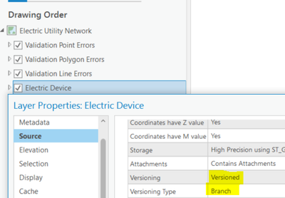

To publish a Utility Network Service, all feature layers and tables that are added to the publishing map must be registered as a branched version.  An efficient way to find out the publishing map’s conformance to this is by inspecting the Configuration tab: Share Tab > Web Layer > Publish Web Layer > Configuration tab
If you see an option to enable “Version Management” capability in the Share As Web Layer pane, you are all set. This confirms that all the feature layers are registered as branched versions in your publishing map.
CAUTION: Do not spend any time changing symbology, renaming layer names or other map changes, before checking that version management capability is present in the configuration tab.  This could be all for nothing if you can’t enable Version Management.
Sometimes, things do not go as planned/expected.  Without the Version Management capability, Utility Network functionality won’t be available upon publishing.  Troubleshooting steps include:
  • Make sure the layers added to the map come from a Geodatabase connection file whose versioning type is Branch. You can check it here: Catalog > Right click on Geodatabase connection file > Geodatabase Connection Properties
  • Inspect each layer in the map and confirm its versioning type is Branch. (Right click on a feature layer > Properties > Source)
  • If the layer is not flagged as branched in the properties dialog, remove it from the map and add it again using the branched geodatabase connection file.
