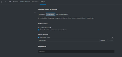

I have created a UrbanDesignDatabase project and shared it with my organization but it does not works.
However, if I share the project with everyone, the project is returned by the function:
{'data': {'urbanModel': {'urbanDesignDatabases': [{'projects': [{'attributes': {'EventName': 'Test'}}]}]}}}
I have verified that I am the owner of the oauth2 application (client id and secret key) which I use with the Urban API and that's correct.
I dont know why I can't query UrbanDesignDatabases that are not publicly shared if I am the owner of the model and the owner of the projects and I am using a valid oauth2 application.
