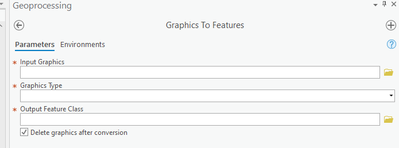

@KoryKramer I tried to use the graphics to features but it appears I can't use a graphic from my layout?  It only gives me the option to browse for a graphic and I'm not sure how to save a graphic from my layout?  Am I missing something?
KoryKramer
Esri Community Moderator
Hi Johanna,
The tool converts a graphics layer (in a map) to features. https://pro.arcgis.com/en/pro-app/latest/tool-reference/conversion/graphics-to-features.htm
https://pro.arcgis.com/en/pro-app/latest/help/mapping/layer-properties/graphics-layers.htm
Graphics on a layout have no relationship to map space; they are just graphics on the page so it wouldn't make sense to convert them to features.
