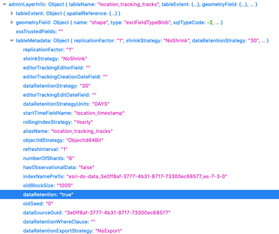

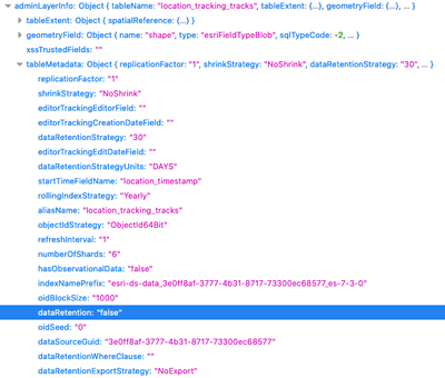

If you navigate to the the admin endpoint for the feature service tracks layer (layer id 0) you can confirm this outside of the UI:
This with the 30 day retention period:
This is with the setting as "Always":

It's a URL like:
/server/rest/admin/services/Hosted/location_tracking/FeatureServer/0?f=json&token=XXXX
And then under the adminLayerInfo-->tableMetadata-->dataRetention (in the JSON)
