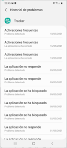

The ArcGIS Tracker application has been causing problems for several weeks.
Suddenly it stops working for no apparent reason, the app crashes, does not respond and does not register positions.

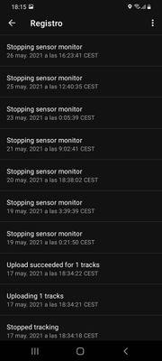

In the meantime could you please let us know whether these logs below tell you something?
Is it what you've asked for earlier?
To me, looks like they're very high level descriptions.

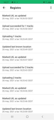

Hi Aaron!
Please find attached the log field generated with Field Maps and let me know whether you find something relevant.
The user reported that his device was overheating when using such an app.
Cheers,
Pablo
by Anonymous User
Not applicable
I don't see anything strange in those logs. It looks like tracking was working as expected and points were uploaded. Do you know if the app crashed or didn't respond at any point?
