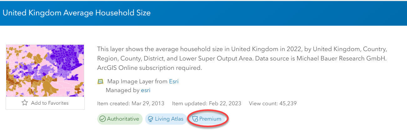

  • Do Living Atlas layers consume credits? Generally, no. Almost every map and layer in the Living Atlas is either shared public by the Esri user community or requires a subscription (ArcGIS Online account) but does not consume credits. The Living Atlas does include a small collection of Premium Content items that consume 10 credits per 1,000 map requests and will have a Premium badge as seen below.
While it is possible for you to add Premium Content to a web map, and then use that web map in your survey, you will not be able to configure geo-calculations or dynamic lists against Premium Content using the Survey123 web designer.  If you want the web designer to make Premium content available, add a comment below.

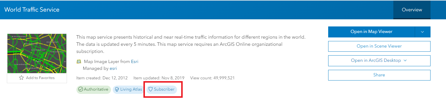

  • If I use Living Atlas layers in my survey, can I share my survey publicly?  Most layers you will find in the Living Atlas are free to use and can be included in publicly shared surveys. It is good practice to carefully read the Terms of Use for each item you use as some content owners have specific requirements such as attribution.  There are, however, a number of layers in the Living Atlas that require an ArcGIS account.  This is what is typically described as 'subscriber content'.  Subscriber content does not consume credits but access always requires an account.  If your survey includes subscriber content, you will not be able to share the survey publicly.
