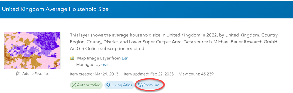

  • Do Living Atlas layers consume credits? Generally, no. Almost every map and layer in the Living Atlas is either shared public by the Esri user community or requires a subscription (ArcGIS Online account) but does not consume credits. The Living Atlas does include a small collection of Premium Content items that consume 10 credits per 1,000 map requests and will have a Premium badge as seen below.
While it is possible for you to add Premium Content to a web map, and then use that web map in your survey, you will not be able to configure geo-calculations or dynamic lists against Premium Content using the Survey123 web designer.  If you want the web designer to make Premium content available, add a comment below.

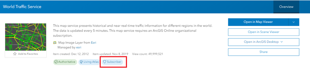

  • If I use Living Atlas layers in my survey, can I share my survey publicly?  Most layers you will find in the Living Atlas are free to use and can be included in publicly shared surveys. It is good practice to carefully read the Terms of Use for each item you use as some content owners have specific requirements such as attribution.  There are, however, a number of layers in the Living Atlas that require an ArcGIS account.  This is what is typically described as 'subscriber content'.  Subscriber content does not consume credits but access always requires an account.  If your survey includes subscriber content, you will not be able to share the survey publicly.

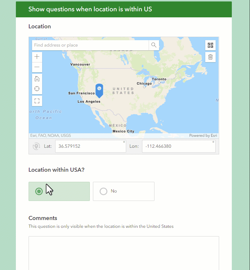

Can you make a location field answer a yes/no question and only show further questions in the survey if the answer was yes?
E.g. ask for an Address/location. If the address is in your government area, question 2 says yes and therefore the person can complete questions 3 and so on. If it is not in your government area, question 2 says no and they cannot submit any further answers.
I think this might be currently limited because while you can calculate a location into a dropdown, it doesn't support a default choice, and also no rule can be applied to choices in the designer.

@MattSund  I created a simple XLSForm to illustrate how you could hide/show questions in a form when a location is within or outside a polygon of your interest.
I did this in Survey123 Connect because with Survey123 web designer it cannot be done at the moment.
If you want to dig a bit more into pulldata("@layer") check out this post. It has additional XLSForm examples.

Hi Ismael, thanks very much for your quick reply. Its exactly what I was asking for!
