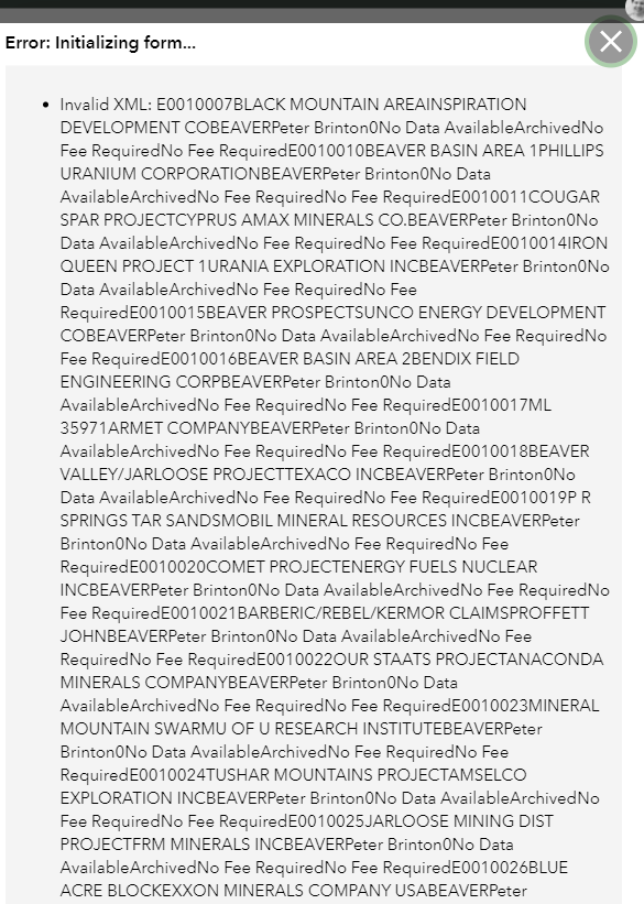

I recently updated this pulldata table and after publishing received this error:
I took some advice from forums I read on here among other sources, yet I still receive this error.

I found what the issue was, a single leading space in one of the fields,
not a field name, but a value in a field.
Thank you for getting back to me!
