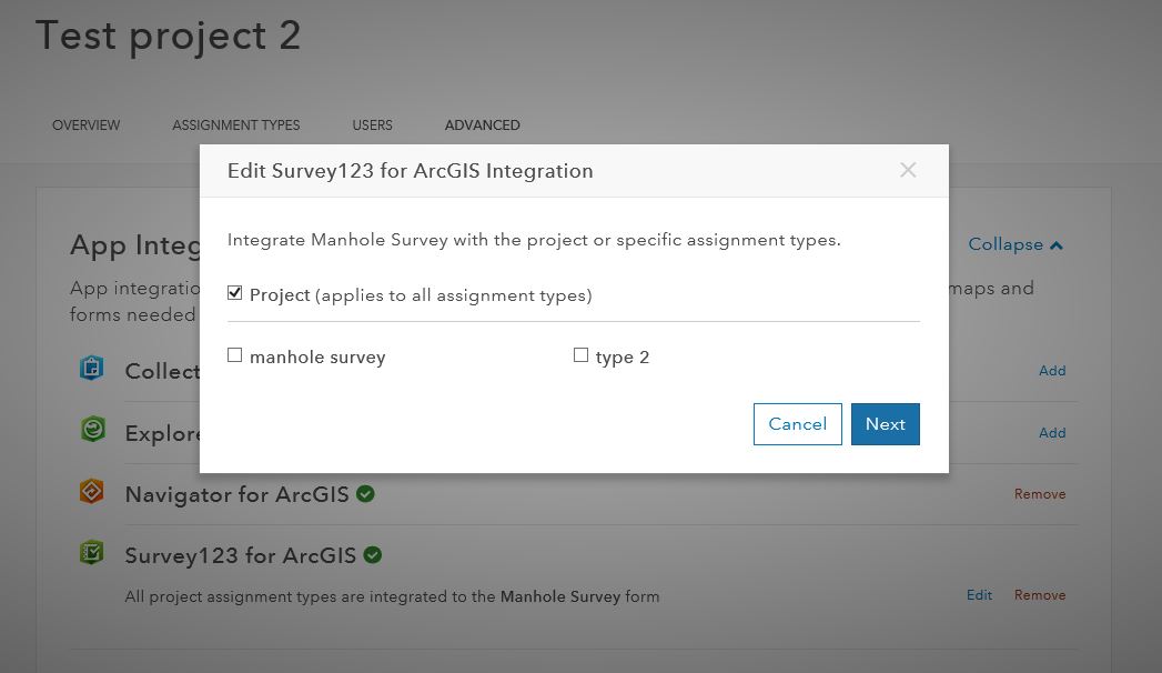

3) In the 'Advanced' tab I've registered the Manhole Survey with the all assignments types in the project

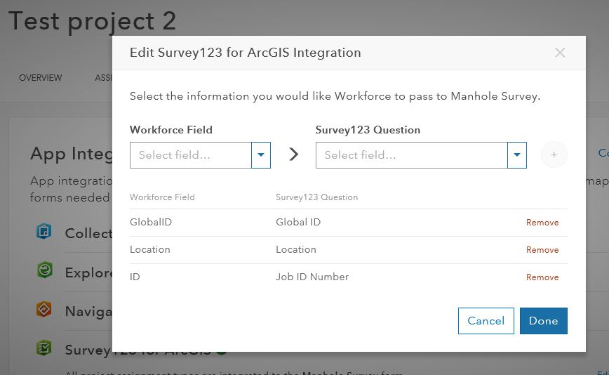

4) Made sure that ID, GlobalID and Location fields are mapped to appropriate Survey questions (string text fields)

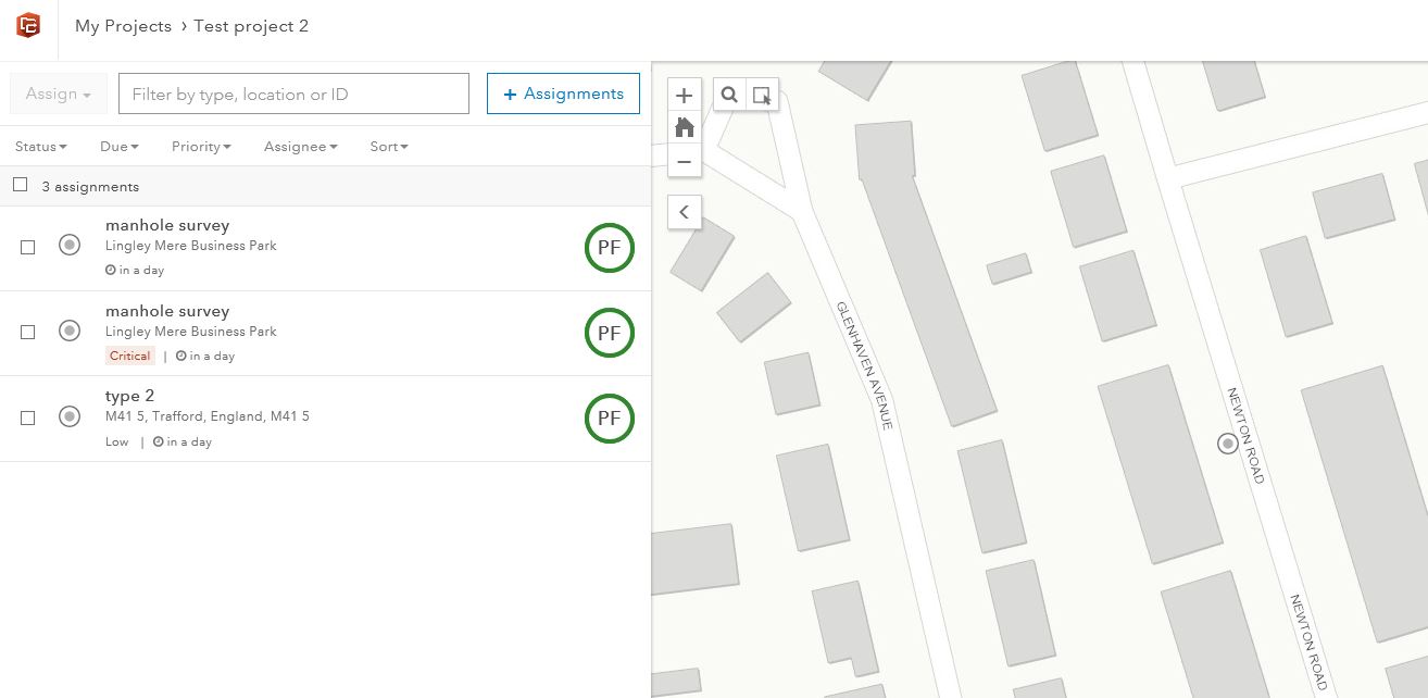

5) Created some assignments in the Workforce project

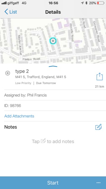

6) When I open the Workforce app (iOS) I see the assignment but when I click on it I don't see any link to open the 'Manhole Survey' / Survey 1-2-3 etc (which I was expecting?). [Note: I also have the Survey 1-2-app installed and have made sure the survey is downloaded to the device].

Hi Phil,
Please click the icon, which provides a menu context for actions to accomplish for the assignment.

PhilFrancis4
Thanks James ! That's probably the one button / icon I didn't try pressing
