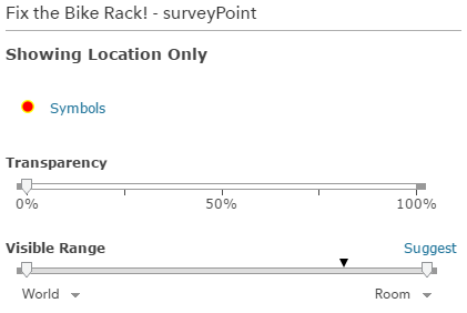

I believe it is not related to the visible range setting since I set it is visible at all range.

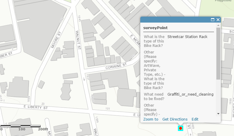

It is showing at the 1:200 ft

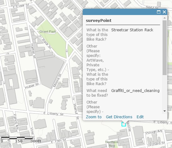

But it is not showing at the 1:300 ft (Notice the red point is missing).

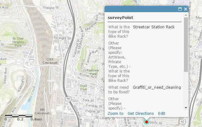

It comes back at the 1:0.4mi scale.
