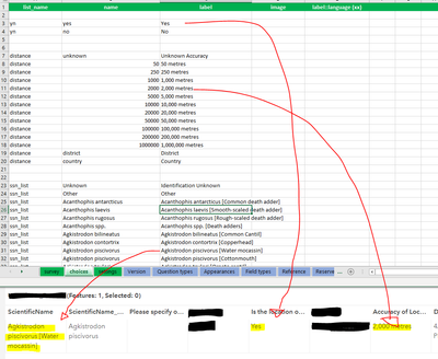

ADM48
I am having a similar issue.  I want the 'name' field to be used to populate the feature service, but instead the 'label' field is being added.  Am I misunderstanding the purpose of the 'name' field.
I'm using ArcGIS Online.  I'm publishing the survey through Survey123 Connect.
