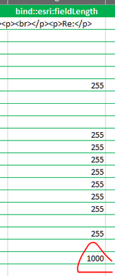

DrJumaKhudonazarov
didn't work I think ham doing something wrong?  the message is that there should be more variables
BrittanyBurson
Hi @DrJumaKhudonazarov you should ignore that part of the screenshot, it's leftover from a different field in my survey. Only the circled "1000" characters in the fieldLength field is what I meant to draw your attention towards.
