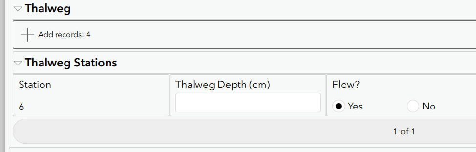

Whenever I use repeat count I get a lot of weird things that happen.  The biggest one is the add records thing.  If it knows it needs 4 more then just add why make me click?
I get it so much that I want to know what is going on here and how to stop it.  I had to start counting myself and adding a constraint but it would work a lot better if repeat count would behave.
In this case it is a nested repeat.
Thanks

No Phil this is not from the Inbox at all.  It is a first time open.  It has been happening to me all the time with repeat count.
It seems to be on nested repeats.  Not sure if you have tested that.  I thought it was having a formula in repeat count but it even happens with a static number.
I just posted because this is about the 4th time I have had to abandon repeat count due to it not working correctly.  Esp in nested repeats.
I can send a sample form if you want.  Thanks

I have finally narrowed down the cause. It is related to using repeat count on a nested repeat that contains a question with a calculation that references another question in the parent repeat. It creates a timing issue with the loading of the values and repeats, which nulls out the additional nested repeat record rows after they are initially created, but before they get populated with the values.
We already have a known issue with repeat count on nested repeats and calculations referencing parent questions. This is another example of that same issue, which I think you have reported previously via GeoNet and I worked on it with you: https://community.esri.com/thread/241314-nested-repeat-with-repeatcount-shows-add-records-box-now
Unfortunately the only work around is to not reference a question outside the nested repeat, or not to use repeat count on a nested repeat. I have updated the internal backlog issue with these new findings and examples.
