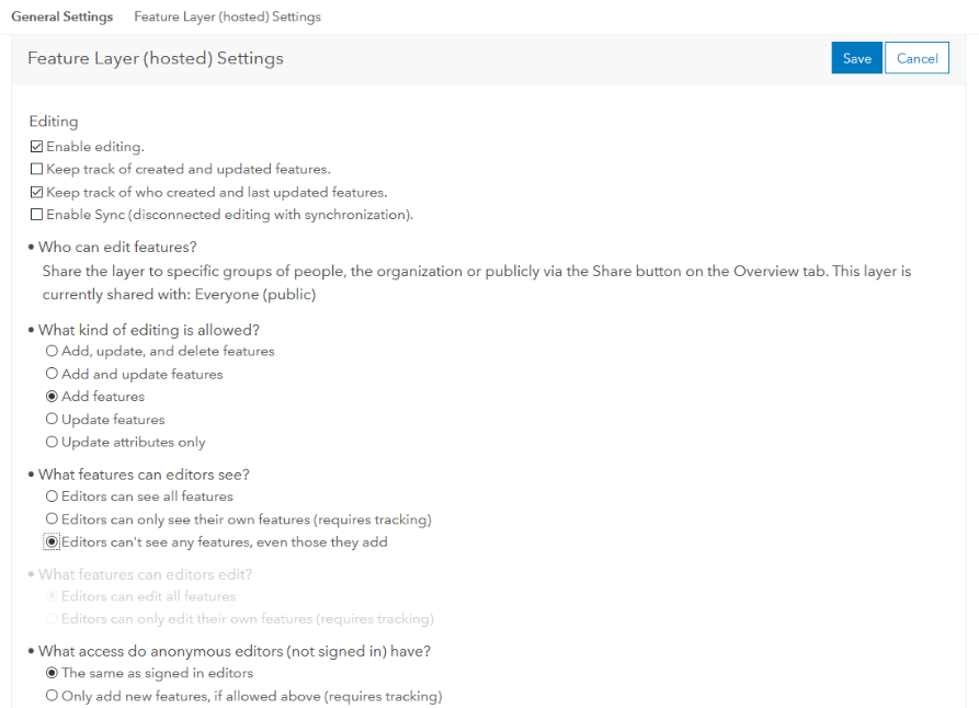

Your feature layer of the form needs to look like the one pictured below:
This is the link on Public Surveys and to make data private. Unfortunately, there is a bug that won't allow the creator of the form to see the results in the Survey123 website. BUT the members of the organization can see the data.
