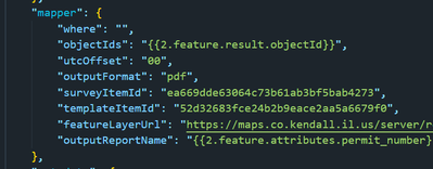

When you request the report from the S123 site, the following parameter is included.
"uploadInfo": '{"type":"arcgis","parameters":{"folderId":""},"conflictBehavior":"rename"}'
If you peek under the hood at your Make flow, you can see that that parameter is not included.
It's not even in the advanced settings, unfortunately. But you can still do it! Add an HTTP - make a request step to your flow, and send a POST to your portal using the addItem endpoint documented here: https://developers.arcgis.com/rest/users-groups-and-items/add-item.htm
Paired with Make's HTTP - get a file step, you can easily pull the report generated and pass it through to the portal, or even email a copy to yourself.
We often do this, but rather than upload the PDF to the portal, we attach the PDF to the feature that the report was generated from.
- Josh Carlson
