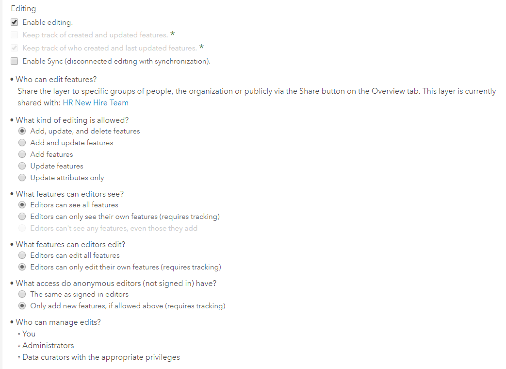

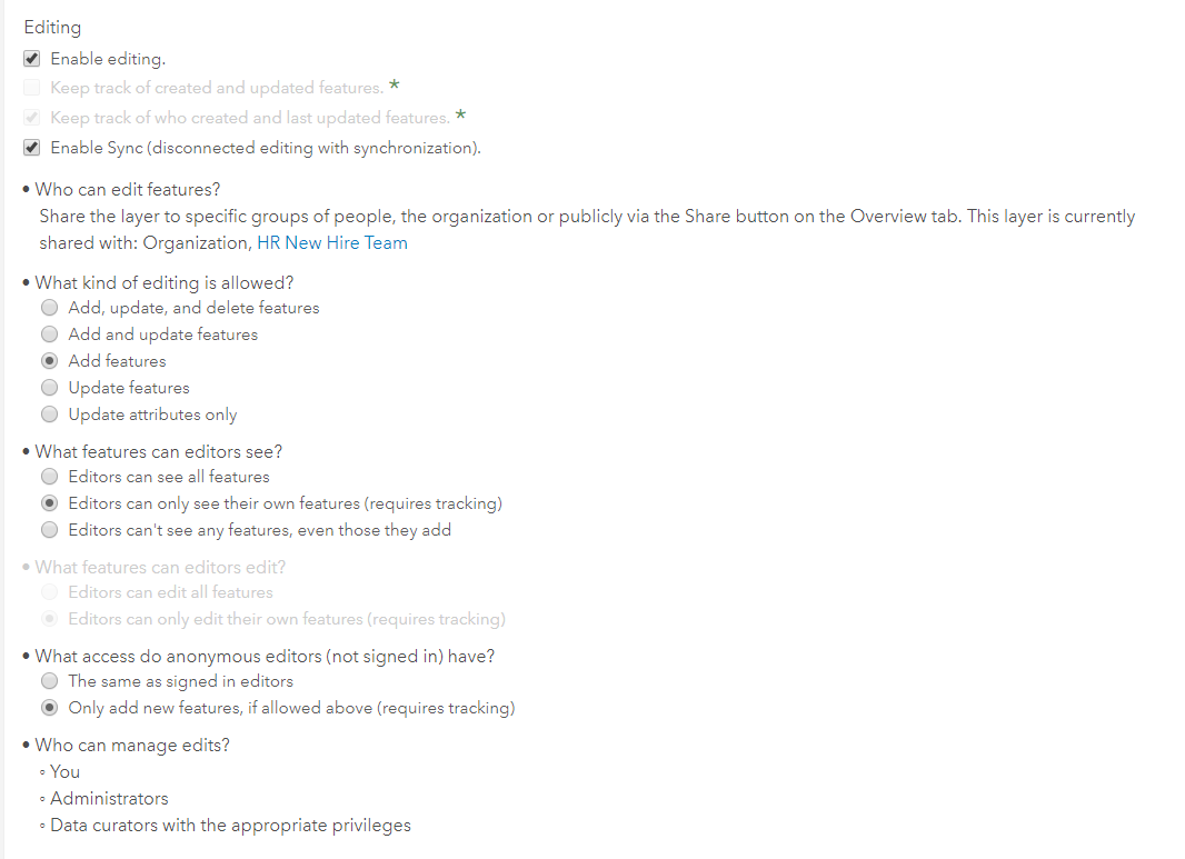

When setting share permissions for Survey123 through ArcGIS Online for a public survey, and I only want a certain group to be able view the data/results or have edit rights, are these the right settings?  I'm sure I found a similar post showing the steps for setup but can't seem to find it now.  The key to making changes in ArcGIS Online versus Survey123 is ensuring everything that only those people who need to capture/analyze the data can, and no one else.  Also the organization has chosen to not give everyone the right to make surveys public, to ensure that the data being captured isn't sensitive, and if it is then ensuring its safeguarded properly.
The Form:
"Hosted Feature"_fieldworker:
"Hosted Feature"_stakeholder
And Lastly the Hosted Feature Layer, which would be the same as the stakeholder setup.

If you want to update the sharing/editing permission manually in ArcGIS Online, you may want to know that how Survey123 control privileges for fieldworkers and stakeholders by utilizing the feature service and feature service views.
There will be 3 feature service (view) items in the survey folder:
  • The source feature service: which actually stores your survey data.
  • The _fieldworker view: which controls who can submit new data to your survey, this is mainly what the Collaborate->Submitter tab manipulates.
  • The _stakeholder view: which controls who can view your survey data/result, this is mainly what the Collaborate->Viewer tab manipulates.
See FAQ: What are the Fieldworker and Stakeholder hosted views used for in Survey123? for details.
In addition, the form item in the survey folder actually stores what questions are in your survey and other related settings (the form itself). So who can access the form item will be able to view your survey form, technically. However, only share the form item to a group of people is not meaningful, since they cannot interact (submit/view) with the behind data.

Editing will be a different story, the detailed settings you see in the Settings tab of the feature service (view) item in ArcGIS Online controls what actions can be performed by users who can access the feature service (view). Please see https://doc.arcgis.com/en/arcgis-online/manage-data/manage-hosted-feature-layers.htm for details.
