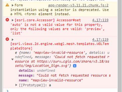

Hi,
I've just noticed that all the map questions on our Survey123 webforms are now missing a marker/pin symbol to highlight where you've clicked for a location to be.  All these were working previously, but now are missing.  Is this a known bug or (new) expected behaviour?  Either way it makes selecting a location really hard and users are thinking that the forms aren't working.
It seems to be the case in Chrome and Edge, although mobile browsers do have the blue marker symbol (I don't know if they use a different mechanism though).  I wondered if it could just be my organisation but I've found examples of other public forms doing it (although not all forms seem affected).  The ones we've made will have been created in Connect.
I'd be really grateful for any advice/info.  Two examples of the forms are linked to below.

hi,
I am having the same issue for the survey using the latest version. There is not blue pin.
