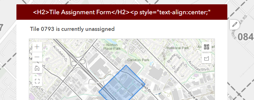

I recently updated my Survey123 connect to a newer version to make use of the dynamic pulling of choice lists from services in the Web Form. I noticed that now my glorious headers formatted with HTML are now no longer working? Not sure if officially this was supported functionality, but it made my Surveys looks really nice
Code: <p style="text-align:center;"><H2>Tile Assignment Form</H2><p style="text-align:center;"</p>
Originally I had this in the Settings Sheet in form_title cell. I have played around with the new settings of generated_note_form_title, but have no had any success getting it to accept the HTML formatting.
Version 3.13.239

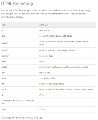

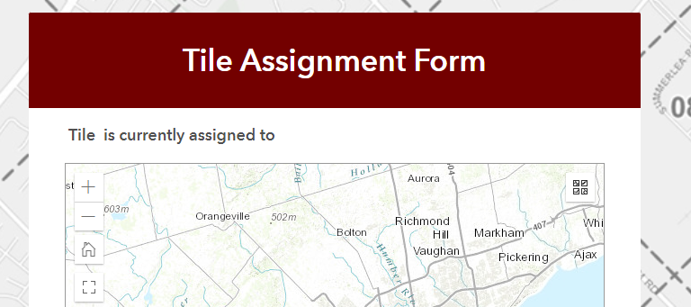

So I have solved my own issue! Always good to check the documentation as it is always getting updated. I see more HTML Tags are now supported which is amazing thanks ESRI!
The issue was being caused by the Header HTML Tag (<h2>) to set the size of the text.
<p style="text-align:center;font-size:30px;"><b>Tile Assignment Form</b></p>
Just setting the size in the style fixed it!
Style your survey:
https://doc.arcgis.com/en/survey123/browser/create-surveys/styleyourform.htm
