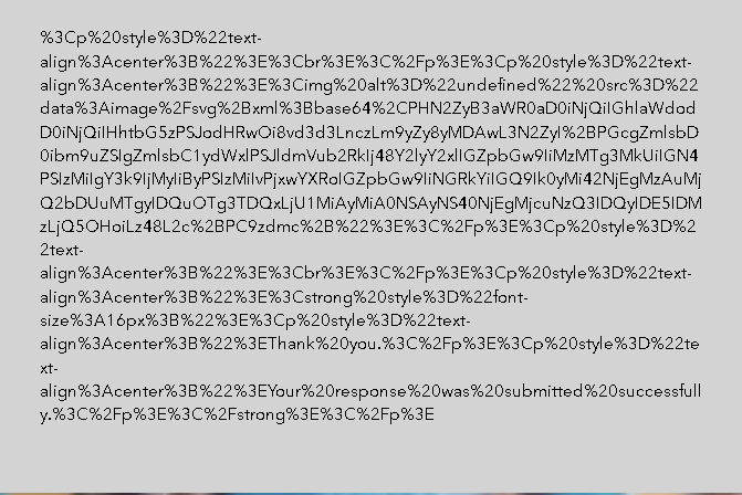

We have a survey that we get staff to complete online. This is what appears on completing the survey. It has only just started happening.
As you can see amongst the escape chars, it says "Your response was submitted successfully" but it isn't a good look.

Hi @PeterMadirazza ,
I am wondering have you republish the survey using the latest 3.16 Connect? You can check the form version in the developer tools (press F12 to open) -> console -> survey published.
I guess this survey was published in connect, then republished in website, then republished again in the latest Connect. If yes, then the cause of the issue is that we improved the mechanism of encoding/decoding in 3.16 to ensure some encoded content will not be decoded accidentally.
If this is the case, republish your survey in the website will fix the issue. You can save your current form as a new form to test the solution I mentioned. Then, republished your current form if the solution I mentioned can work without issue.

Hi @Ruth_JiatengXu ,
This form was published initially in 3.15 and now republished in 3.16. When I look at the console properties of the form, the survey is published in 3.16 and final render is 3.16
Republishing the website in 3.16 hasn't made any difference unfortunately.

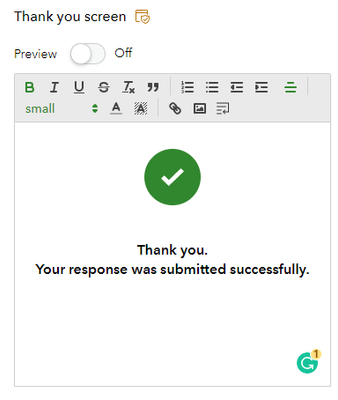

Thanks for your reply, and sorry for the inconvenience. We are going to fix the issue, before the fix is available on production, you can fix the issue by editing the thank you screen content and republishing the survey in the website.
I will reply to this post once the issue has been fixed.
Thanks,
Ruth
PeterMadirazza
Thanks for the notes. I was able to fix the thank you screen and republish.
Cheers,
Peter
