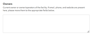

Sure enough, here is a field in a new survey entry:
And an edited entry:
The counter is missing from the latter.
