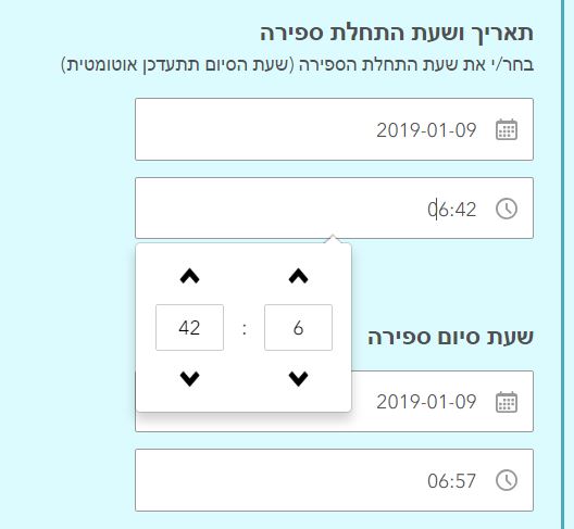

In question type of date and time on the web form, the hour and minute buttons are reversed.
Instead of displaying 6:42 the form displays 42:6.
Reversed hour and minute buttons
Is there something I can do to change that?
In addition, can I force the web form to display date format as dd/mm/yyyy instead of yyyy-mm-dd?
Note: I'm using Hebrew (he) as the form default language.

I am not seeing the same behavior when viewing a survey created using Survey123 Connect with Hebrew as the default language.  Can you please share the XLSForm that you used to create the survey?  Also, what is the default language of the OS and browser where you are seeing this?
The behavior with the formatting of the date appears to be a bug.  I will log that on our end to be addressed as soon as possible.  In the meantime, you can add a text question and enter a calculation such as
format-date(${previous_time},'%e:%m:%Y')
