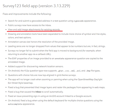

As from:
Survey123 field app (version 3.13.229)
View and add image attachments for existing records is now supported:

As from:
