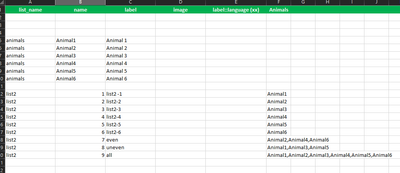

DeonLengton
Hi Alfred
Do you mind attaching your Excel design file of your survey? It would help a lot to see how your choices are structured to see exactly what you're trying to achieve.
DeonLengton
Hi Alfred
I had another look at what I think you are trying to achieve. I stand corrected but i dont think you can create an "expression" inside JavaScript and then have it execute as an expression in Survey123. I think it just returns the string/text that your function calculates.
There is a less elegant way to achieve what you're trying to do in Survey123 and it will highly depend on the number of choices that you have in your survey.
I've created a survey with a select-multiple question (animals) and then a second list that grows according to the items selected in the multiple select.
I've seen before that null values can mess around with calculations so i first did some calculations to see which choices were selected in the multiple select:
Basically if an option is not selected I just defaulted the calculation to the "notselected" string.
Next I did the filter calculation based on this expression:
contains(Animals,${c1}) or contains(Animals,${c2}) or contains(Animals,${c3}) or contains(Animals,${c4}) or contains(Animals,${c5}) or contains(Animals,${c6})
I hope this helps, although I could see that you were looking for a much more elegant solution!
I have attached my XLSX design file as well.
