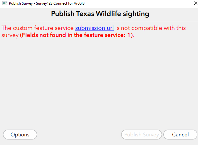

this is what my table looks like as well as the error i'm getting:

Hi Chris,
It appears that you may have created your survey based off of an existing feature service. As the message reflects, the field does not currently exist in the feature service being referenced by Survey123 Connect and therefore does not have a place in the schema to write the values that would be collected.
In order to resolve this error, please try to manually add the field to the feature service using ArcGIS Online or ArcGIS Pro.
The name of the field that you will want to add is 'burrow_species_other' so that the schema will already be present in the service that you are looking to create a survey from.
Once you have added this field to the feature service, please try to publish your XLSForm again using Survey123 Connect.
