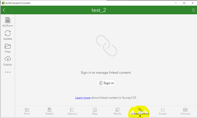

I'm designing a survey with Survey123 connect and for one of the questions I wanted to add a map I did myself on ArcGIS Pro, to use this as a base map to collect geo-data. Is it possible to do this or do I need to use the base maps that the app offers?
I know it is possible in the Survey123 online app, but I haven't managed to do it with Survey123 connect. How could I do that?
Thanks!
AnaDeniston
Hi @EiderEtxeberriaNieto
You should publish your ArcGIS pro map into ArcGIS online. Once you have your online map you can "linked Content" as a basemap to your survey123.
A default basemap can be set for individual map questions using the map parameter in the body::esri:style column.
This Esri help link might help you and guide you through the step.
