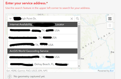

I am working on a survey with a geopoint question that will be publicly available for customers to enter their address and search for internet options available. I would like for customers to only see address options in our area of Texas when they begin typing their address, as we want to make sure they are not confused by potential address options in other states. I have two questions about this workflow:
1. Is a locator view now supported for publicly shared surveys?
2. I have set up a locator view for testing that seems to be working with the survey shared to our organization. However, I only want the locator view to be visible and not the ArcGIS World Geocoding Service. Is there a way to do this only for this survey without deleting the ArcGIS World Geocoding Service all together? This is how it currently looks:
Please let me know if there is a way to only show the locator view in a publicly-shared survey!

IN the bind::esri:parameters field do "geocode={IDofgeocoder} the ID of the geocoder can be found on the information page on arcgis online.

Here is how you can do that. Uncheck *use all contents below" and just choose the one you want.
