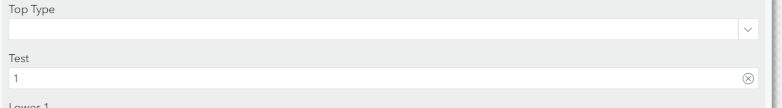

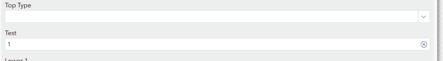

I know pulldata has issues when in an if, but even if I move it to its own field it still happens.  Weirdly if I say yes to use defaults it populates, then I hit X and it all works.  It is just the first drop down.  Also if I start typing the values are there and work.  Its just the down arrow to drop down the list that breaks.
Attached is a simple form to show it happening.  Rename the js file from jpg since I can't upload that.
