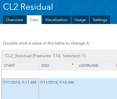

I have examples of a survey with a username question and the username is not getting populated.  We have just noticed this occurring in the last few weeks (maybe 6 occurrences in the last month out of 1,200 submitted surveys)
The survey is hosted on AGOL and shared with a specific group.  It seems as if the user is able to submit the survey without being signed into Survey123, because the username question is not being populated.

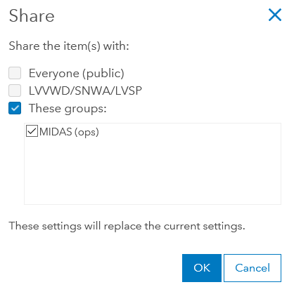

Image of survey shared with a specific group:
Image of USERNAME column not getting populated:

One thing to check is the sharing permissions of the service - does this match the survey and does it allow anonymous submission?
JakeMatthys
Thanks for the reply Johnathan.
Both the Survey Form and supporting Feature Service are shared with the same specific group.  They are not shared with 'Everyone', nor are the shared with the whole 'Organization', only a specific group within our organization.  My understanding is that since the Feature Service is only shared with a specific group, that prevents anonymous submissions.
Any other ideas?  Should I submit this as a bug?

JohnathanHasthorpe
Also - I'm aware of the following bug:
If you open up a survey with a username question from drafts, that was originally saved offline - the username question does not populate.
Does this sound like a possible cause in light of your user workflows?
JakeMatthys
Hi Johnathan,
Thanks for the info.  Yes this scenario is a real possibility.  In fact it is the most likely cause.
