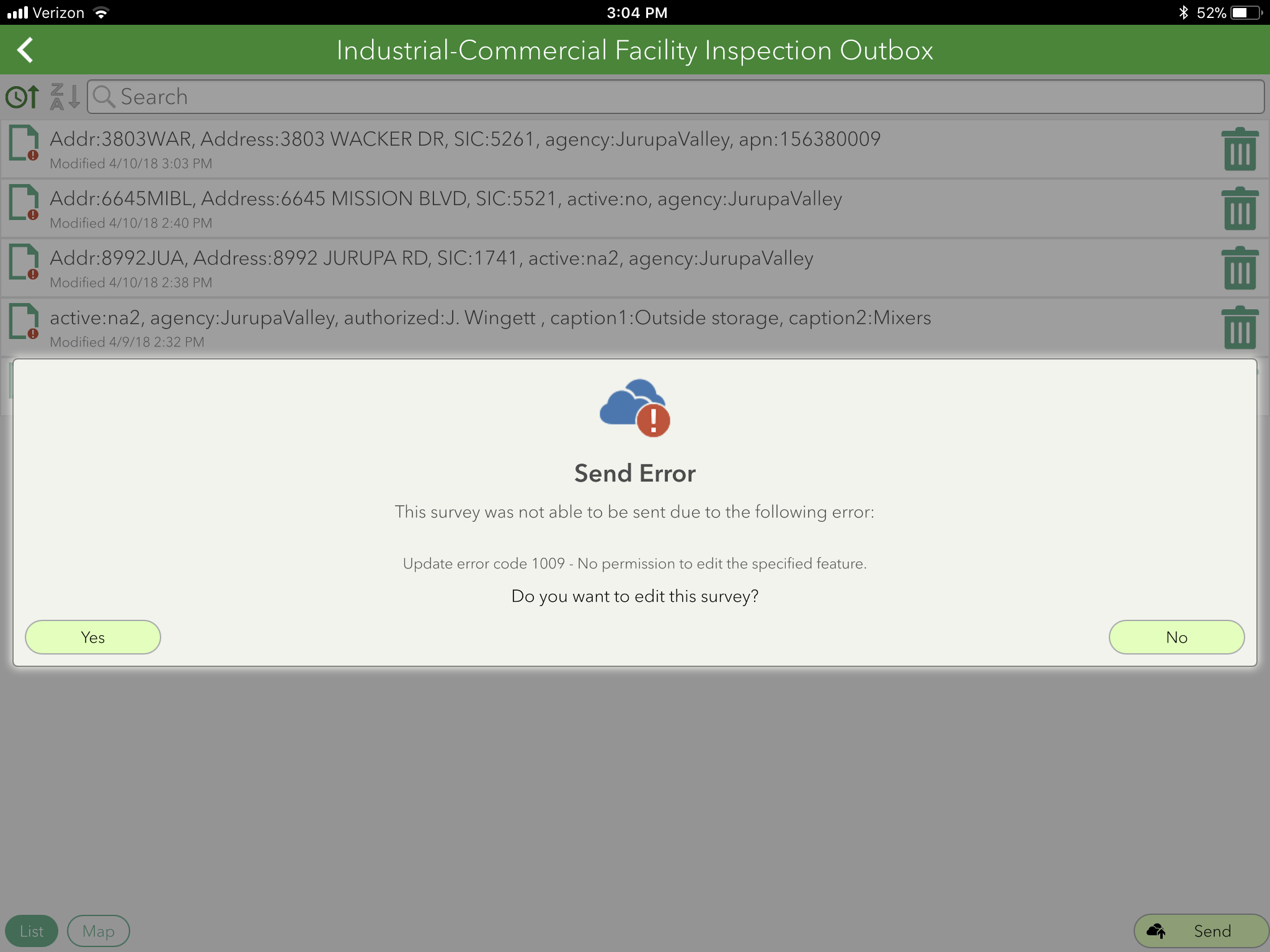

Off site user submitted surveys from 4/6 & 4/9 but did not get uploaded to AGOL.
User sent screenshot of error 1009 - No permission to edit the specific feature.
error message outbox

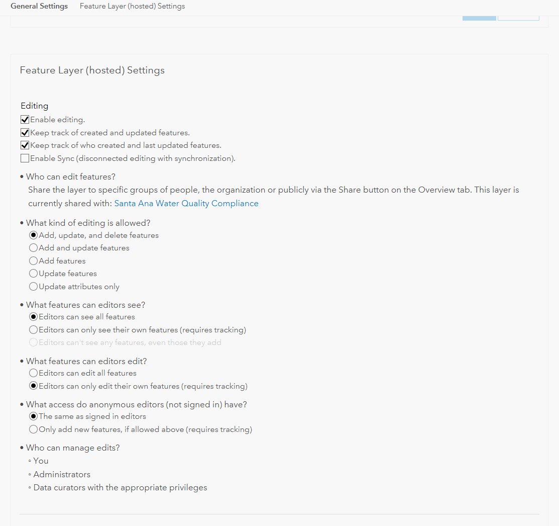

I checked the settings as attached/shown:
AGOL feature layer setting
I had suggested to update the app to 2.7 since the update was posted 4/4. Also, recommended user to make sure to check the sign-in is correct username in the survey123 field app. I am unsure why the user is unable to 'edit and resend' or 'send' their surveys. I was able to send a test survey just now without any issues (no changes were made to the form), survey was working fine (user had already entered 200+ surveys without any issues). I checked survey123.arcgis.com settings in case the settings got reset from the update but was fine.

I'll point out the setting 'What features can editors edit?' - it currently is et to being able to edit only those features they own.  Can you try setting that to 'Editors can edit all features' and have your user attempt submission again?
AldousTsang
  After changing the setting, the user was able to submit but none of the surveys uploaded to AGOL (also surveys "sent" from the device after 4/5 was not uploaded to AGOL). We were only able to 'edit and resend' one survey to be uploaded to AGOL, other attempts did not work on older surveys. The user has about 20 surveys between 4/5-4/10 that did not upload to AGOL while running the older version of Survey123 on an iPad.

Given the editor permissions change succeeded, it appears that those were edits to existing features, not the addition of new features.
