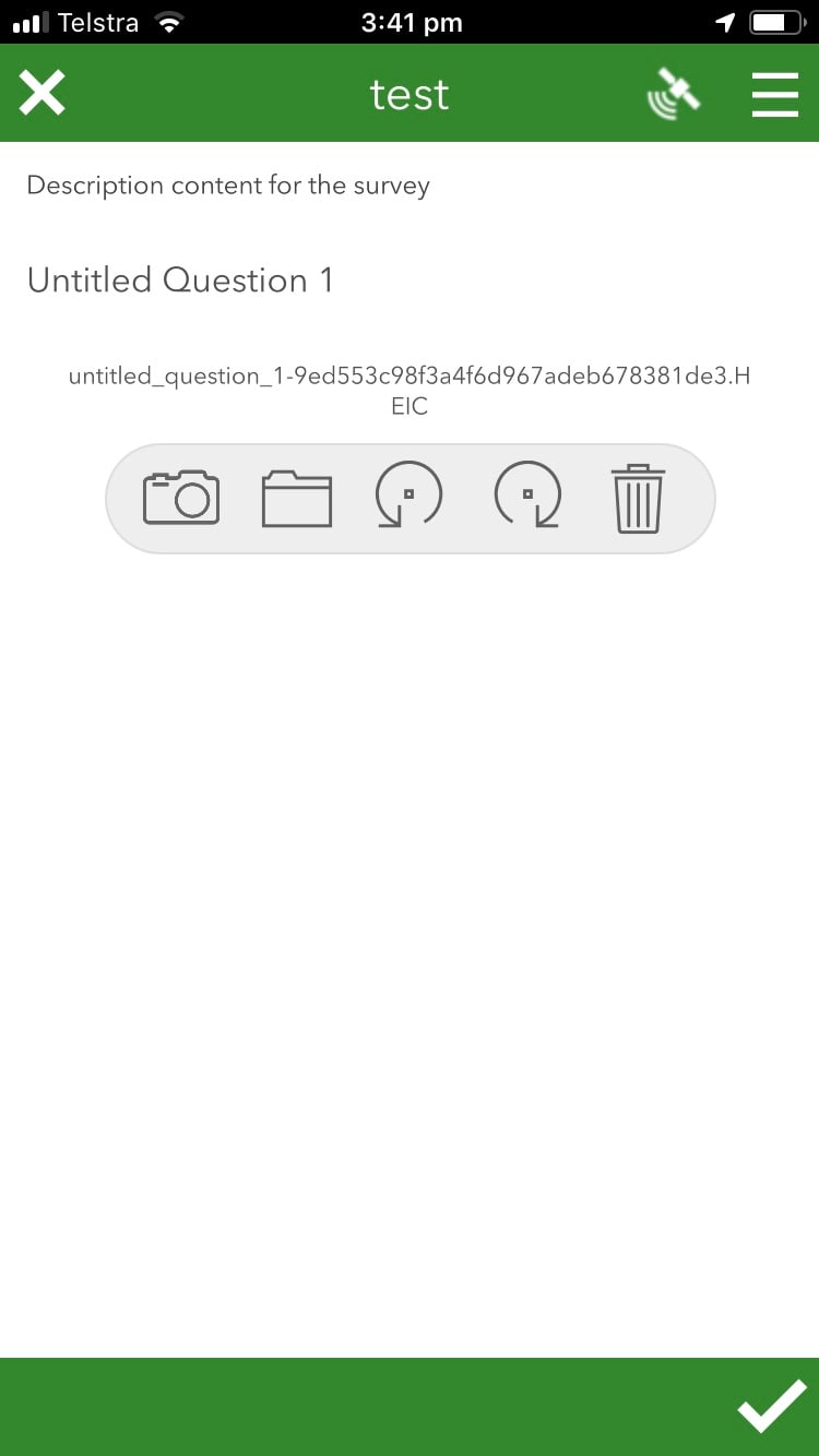

I have also used the same users phone to try to attach a photo which was taken using the native iphone app, and use the browse button, select the photo from camera roll, and this is the end result:
you can see that the photo is referenced, but there is no preview of any photo within the survey123 form, but there is a preview when scrolling through the camera roll. When this form is submitted, once again it can be found on the server sans photo, all other form information is submitted no worries.
