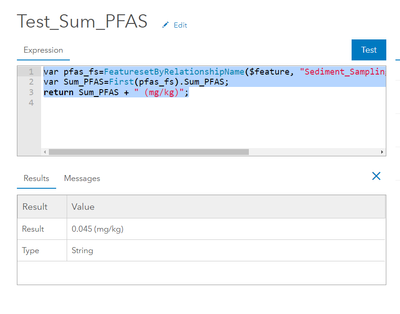

I have looked into using FeatureSetByRelationshipName, thanks. Unfortunately I still run into problems.
When attempting to use FeatureSetByRelationshipName in ArcGIS Pro as a label I get the following error, so it looks like Arcade Label profiles don't support related data in Online or Pro 😞
