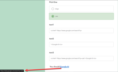

JenniferAcunto
The web app is much less forgiving with syntax than the desktop/field app. I have much better success creating dynamic hyperlinks for the web app by splitting it up into multiple fields, and then concatenating them together to create the link. You can set the bind::esri:fieldType to null for these extra fields to null so they are not recorded in your data.
