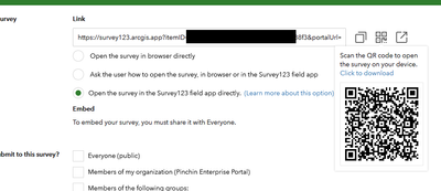

If a QR code will work, that is native to S123. Go to the Collaborate tab in the S123 Website, make your selection from the three options, then click the "QR Code" button:
This gives you a plain QR Code. If you want something fancier, there are QR Code services as well where you can create fancy colourful QR Codes.
