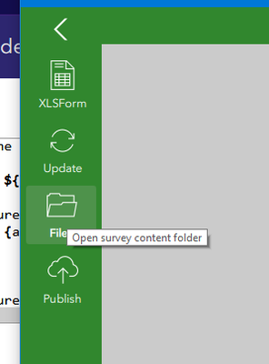

If you need to use it offline, then the media folder is the only way to do it. In Survey123 Connect, you can click Files to open the folder.
You'll see the media folder in there.
