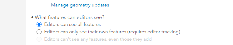

There is a setting on the Portal/AGOL feature layer page that must be checked in order for editors to see items they did not create.  Like so.....
