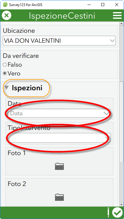

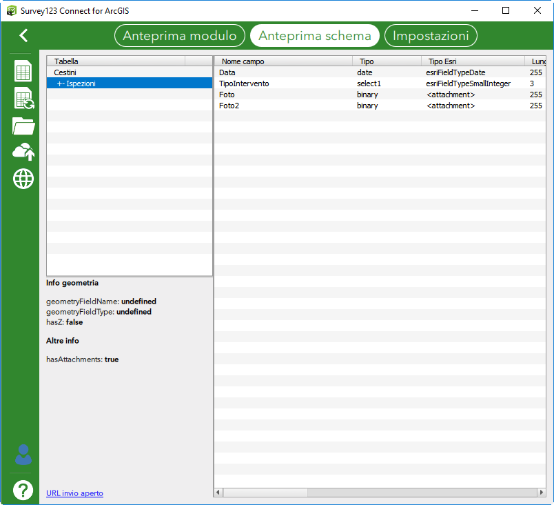

I'm tring to update record from a related table (Ispezioni) with attachments
In this table I woulkd like to insert a new inspection, but also update an existing one if necessary.

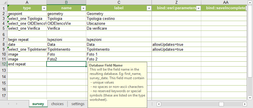

According to documentation for editing existing data (Prepare for editing existing survey data—Survey123 for ArcGIS | ArcGIS ) I set key value in "esri:parameters" column like in image below

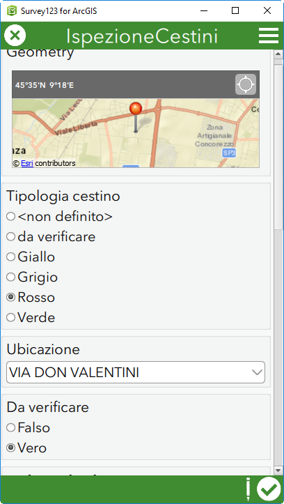

Unfortunately when I open my asset from inbox (with a query) I can see all questions from feature class table, but not from related table (date and select_one questione type)

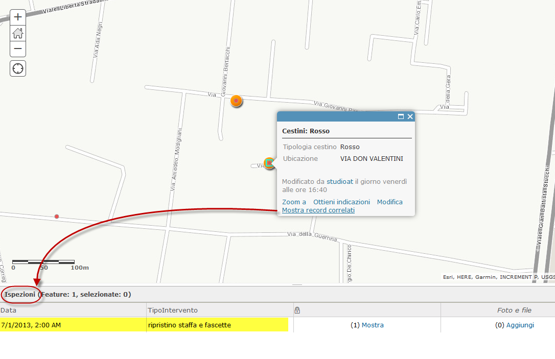

And of course yes, there is almost one inspection for every asset (image below is the same of that inspected with Survey123)

Hi Stefano,
You need to put the allowUpdates=true parameter on the begin repeat field, not on each of the questions in the repeat.

SMauri
Hi Philip, thank you for your answer.
Unfortunately no data appears also after putting parameter in right place...any idea?

SMauri
Ok solved...I missed to insert key word "query" as parameter...
