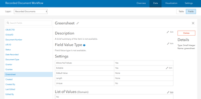

On your layer's Data tab in Portal, can you go to the Fields sub-tab and edit the domain there?

I can get to that page, but when I go to Edit for List of values all I can do is add a new domain or delete the existing one. All it shows is label and code, both of which are sam_street.
