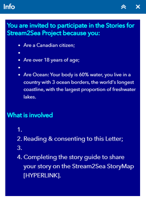

Hello,
When using Survey123 Connect to create unordered or ordered lists beneath specific titles (titles in colour, list items not), I find that the first bullet in the list is also coloured?
I'm wondering if there may be something wrong with my html code for this?  I'm open to suggestions!
Many thanks,
Jen
Code example for screenshot below:
<div style="font-weight:bold; font-size:15px; color:#00ffff">You are invited to participate in the Stories for Stream2Sea Project because you:</div>
<ul><li><div style= "font-size:15px; color:#ffffff">Are a Canadian citizen; </li>
<li><li><div style= "font-size:15px; color:#ffffff">Are over 18 years of age;</li><li><li><div style= "font-size:15px; color:#ffffff">Are Ocean: Your body is 60% water, you live in a country with 3 ocean borders, the world's longest coastline, with the largest proportion of freshwater lakes.</ul><br></li>
<div style="font-weight:bold; color: #00ffff; font-size:15px;">What is involved</div style="font-weight:bold">
<div style="font-size:15px;"><ol><li><li><div style= "font-size:15px; color:#ffffff">Reading & consenting to this Letter; </li>
<li><li><div style= "font-size:15px; color:#ffffff">Completing the story guide to share your story on the Stream2Sea StoryMap [HYPERLINK].</li></ol><br>

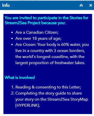

You're opening lots of div and li tags without closing them. Survey123 seems to do a lot of work to hide that, but this is what the result should look like (Info widget in a WebApp; you get the same result when you copy your code into a text file, save that as .html and open it with your broser):
I don't know why your first bullet point is colored, you did close those tags correctly. It could be a result of Survey123 fighting with your code.
