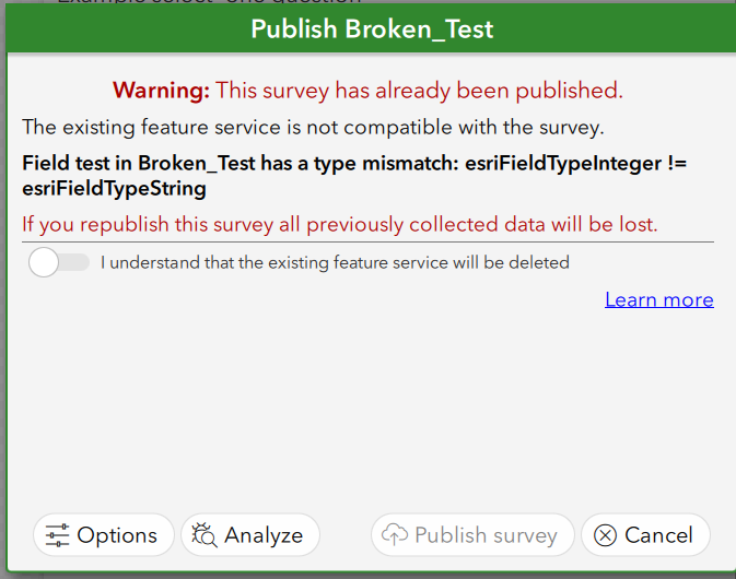

Hello,
I'm trying to better understand the contexts in which this scenario occurs. I'm using a couple of surveys in production with plans to create more, and I have worked around this issue before. But it is quite disruptive and disconcerting.
I have been unable to find specific documentation for this. I know that adding or removing fields is fine. In this case for testing purposes I changed a field type after publishing. That makes sense. I think adding attachments also necessitates a full re-publish?
I would really appreciate any insight, but ideally a full list of scenarios that lead to this issue if possible.

Things that result in a republish:
  • Changing field types (e.g., String > Integer)
  • Changing field character limit/length (e.g., 255 > 300)
  • Adding a repeat

That does clarify somewhat, but it seems the official documentation is not complete (for example the field character limit, and adding photos also force a complete re-publish).
abureaux
MVP Frequent Contributor
Sorry. That is an odd interaction that I should have specified... Photos/attachments are technically added to a related table. The real thing that causes the republish isn't "repeats" it's "related tables". All repeats add a related table, but not all related tables are for repeats.
Related tables can be photos, repeats, and attachments.
